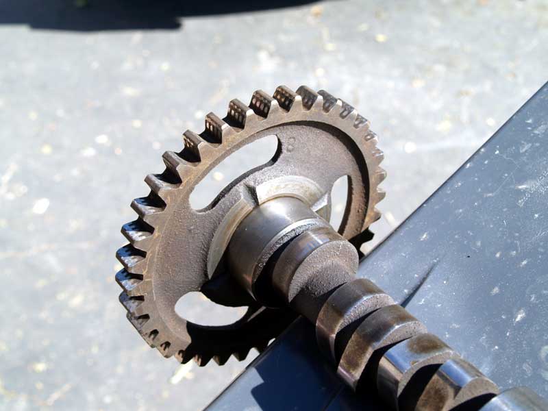

Pull a valve cover and check if you are getting a good flow of oil at the rocker arms. If your rocker arms have a strong oil flow your lifters must be getting oil also, and something else is causing your rattle.
If the oil to the rocker arms looks weak you could have a partial blockage at the rear cam bearing. Hydraulic lifters pump more oil to the rocker arms at high engine speed. Notice how one of the cam bearing holes is partially blocked off in this picture. This would pass just enough oil to the lifters for idle and low speed but would starve the lifters for oil at high speeds. It’s critical that both cam bearing holes are lined up perfectly with the slot in the cam journal on these early engines.
