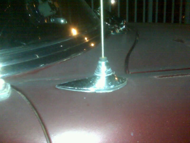

i have a chrome top on my antenna with the original base, the teflon is a good idea you should try it, might work, for the rear end, someone told me one time just fill it up to the hole, i dont know if thats how it should be but it hasnt given me any problem and it runs good
Where did you get the chrome top.
thanks
otis:)
Mine is a chromed piece as well, and looks to be original. It's a Canadian car so maybe that's another difference?
edit: found this on one of tri-five's sponsor sites. It's not exactly like the one on my car but perhaps it would fit? There are several other similar units on that site as well.

i got it in ebay, ill post a picture of it later on today when i get my camera.
