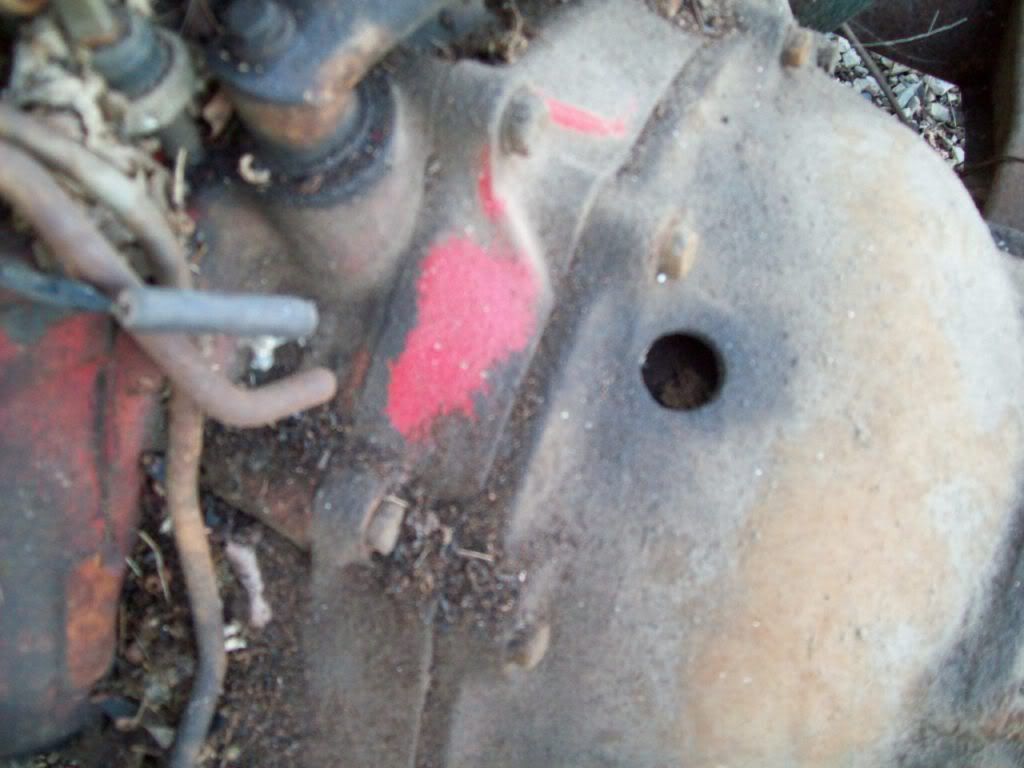

This is a 265 and Powerglide from a 56 Chev wagon. Original to the car, never been apart. (Till I cut the body off) I noticed this plate in between the block and the transmission. I plan on using this motor in my 57 wagon. I may use this powerglide, but im not sure yet. I'm assuming a 350/400/700R trans will bolt directly to the block, Whats up with the plate in there now?

EB...What you are referring to is an adaptor plate.....You will not use it when bolting-up a later transmission, such as a TH-350, or 700-R4.
However, you will need a starter adaptor plate, because there are no starter bolt holes in the 56, 265 block....See link and photo below:http://www.danchuk.com/ItemForm.aspx?item=10100

EB....Personally, I would not bother having an original PG rebuilt, unless you were doung a purely stock rebuild on the car.....Put in a 700-R4 and enjoy the difference in the ride....Less noise and wear and tear on the engine....Better MPG as well....Drives more like a modern-day car.
