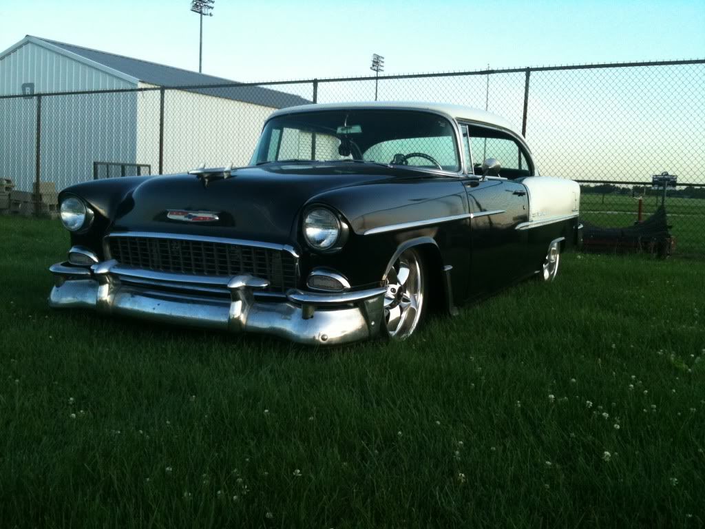

So I've had my 55 since april. I bought it from a great guy in San Fran, who built the car. It is a driver's car w/ 454 that's been worked. My almost 2 year old and I decided to run to the grocery store the other night and as I was pulling onto the country road I decided to hit it. I think my daughter gets a bigger kick out of it than I do lol. So she shifted from 1-2 and BOOM. Pull over to the gravel and see my driveshaft laying on the ground. Turns out it broke the yoke in the rear end. I had planned to take pics today so I could enter them in the calender thread. This is all I have to enter. ARGHH!

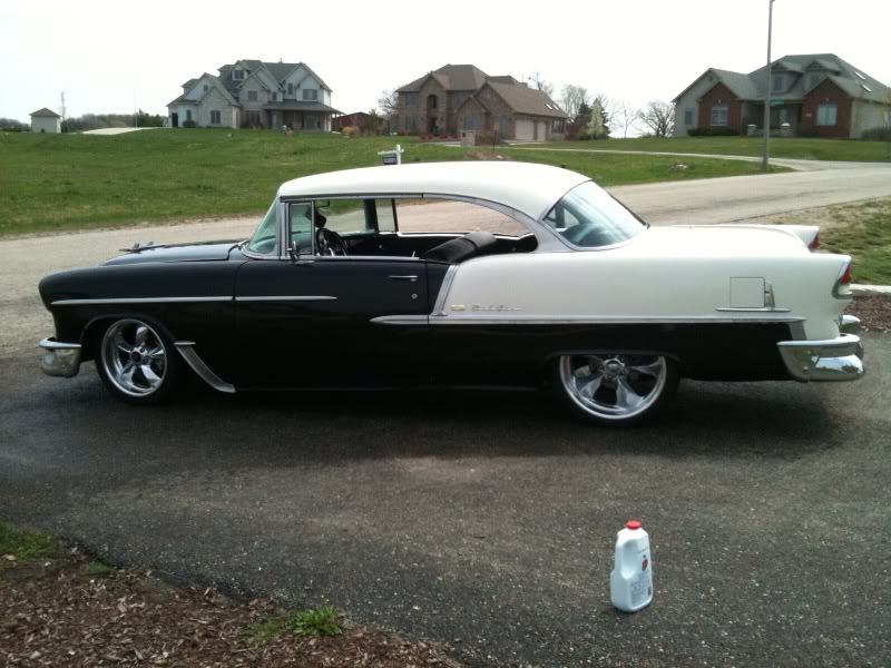

It was a long time since I saw this combination... :confused0006: it actually works really well.
Normally I'm not a fan of those big inch wheels but this was very nice :tu:tu:tu
I think it is the combination with the color, gravel plate, California bumpers and correct ride hight. I gives it another, slick look... me like :cool:
