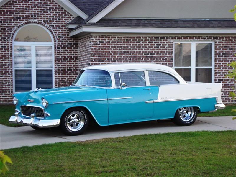

I've posted a plethora of pictures of my car on this forum. I get asked often about how my car is lowered etc.. For years I used the original old springs with 2" blocks and SSM bars. It looked great but rode very stiff. I never really liked the blocks either. So, I decided to change up the rear suspension and I ordered some "2 1/2-3" " dropped rear springs from Cliff's Classic Chevrolet (one of our sponsors). I also bought his traction bars so the ride wouldn't be so rigid. I can say, the car sits within 1/2" of where it was before, but now it rides great. I did a little "line lock" stress-test this evening and the bars seem to work OK too. So, if any of you are using 2" blocks, you might consider doing the lowered springs. I believe the upgrade was well worth it.

beautiful look mike. you did good. :five:
19,595 Posts
Nice stance Mike:tu I have new (3 years ago) 4 leaf with 2 inch blocks and air shocks on mine but not 100% happy with the ride... I might concider what you did... Later, Dave

again, teriffic car you have there! i looked up cliff`s. i would like your opinion on the traction bars ya bought from him. do you like these better than the SSM`s ? i realize the car MUST ride better. thanx.

Hoss, the stance looks great and the color combo is fantastic. If it rides like it looks then you are floating on the clouds.
Cliff's bars are McGaughy's.. which are commonly sold by most of the parts vendors. I had similar bars (but not the same) in the past and they didn't work too well. I hope these do better.. Being the tight-wad that I am, I didn't spring (no pun intended :)) for the CalTracs that I know are the best out there. So, to answer your question, are they better than SSM's? Well.. they certainly ride much better! On the other hand there is a bit more body roll (yes, I do have a front sway bar), and I doubt they will really plant the tires like SSM's or CalTracs. I haven't had them on the drag strip yet either. For an initial test, last night I got out on a country road over a nice new concrete bridge, and I locked up the front brakes with my trusty Hurst Roll Control and did a very nice smoooookey burnout. Felt pretty good.

The rear tires are BF Goodrich Radial T/A's, 255/60/15"s on Cragar Street Star 15X8" "reverse" rims (factory built not custom offset). The back spacing is 3 1/2". No the rear axle is a not original. It's a 9" F**d, that is 58" from mounting flange to mounting flange.. about 2" narrower than the 60" stock trifive rear. I don't think you would be able to put these tires/rims on a stock set up. The fit is VERY tight on mine, but I really like the deep-dish look. Below is a rear-view picture taken a few years ago down in Ocean Springs MS during "Cruising the Coast"

Yes! Looks even better now with little bit extra lowering in the back. My understand of traction bars was they stiffen up the ride though, not smooth it out?
