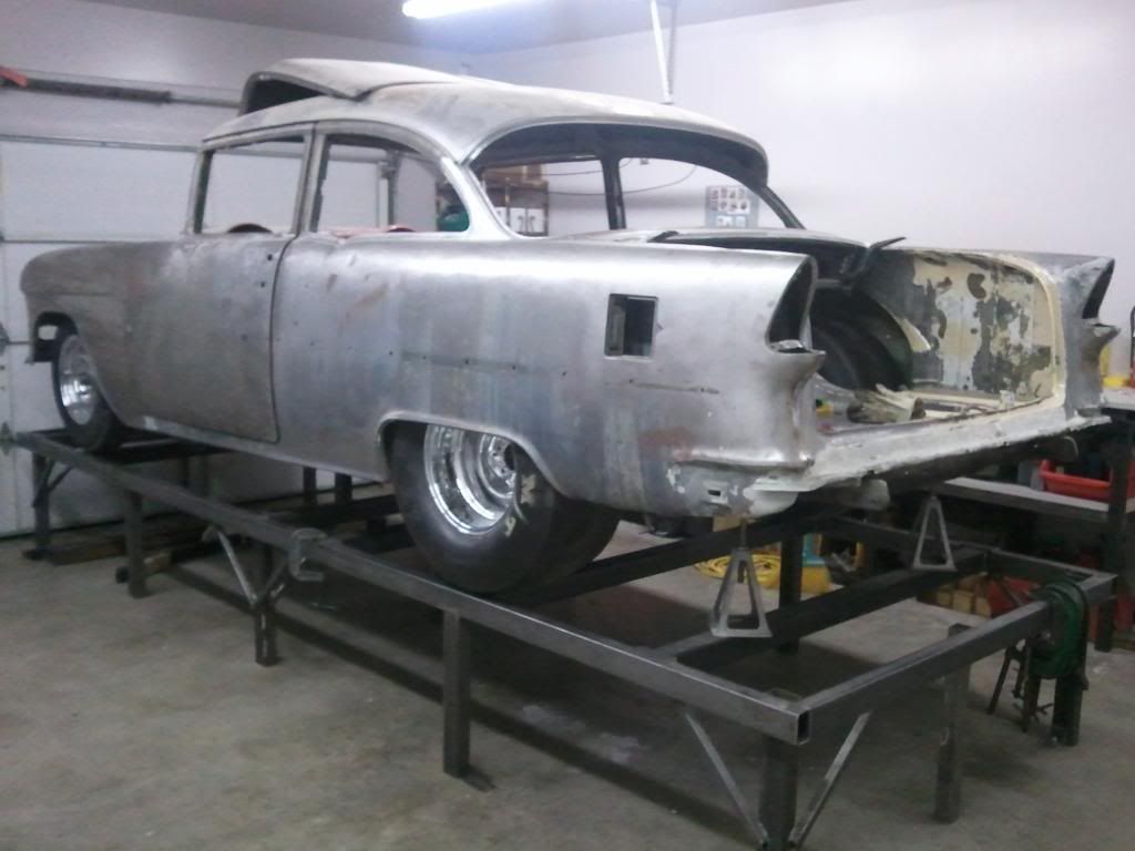

I am pretty new here, but I thought I would post some pics of my project and get some feedback. I've owned the car for about 7 years and have just been working on it for the last year or so. So far I have built the motor and just about finished the frame work.
So far plans are for a good ol 427 and turbo 400. Fenderwell headers, Chrome reverse wheels and lots of Candy Red. I built a frame table in my garage for the frame work. Here are some pics after I set ride height.

Both the motor and car look cool.
Looks like you're going to have the same rear tire change problem I have. I have to jack my car 4 feet in the air, and then fight to get my rear rims off. It's actually even worse and more involved than that.
Anyway, I like your car already. Hop you post pics as you go.

Tire changes will no doubt stink. I am in the process of narrowing the frame rail 1 1/2 inches and fabricating spring pockets. Here's a few pics so far.

these are just pics of moving the frame over. Tires are 30x13.50 MT ET streets on 15x10 wheel.
