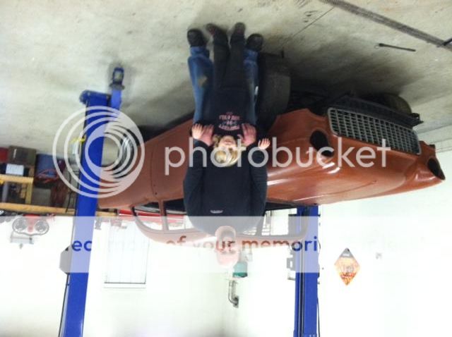

And the best one. One of my goals when I started my original project was to have my Dad take me for a ride in my own 55. Mission accomplished!:
So, now instead of having to use my garage time doing body work and rust removal, I can spend time making the ol' girl mine! I have a bunch of parts I've accumulated over the last couple of years that will fit the bill nicely. First up is going to be a power/disc brake conversion for the front end. I also have a Uni-steer rack and pinion kit that I can get on there in the future as well. I have a complete Painless wiring harness if I find the wiring to be too much of a problem. I still have my complete L33 LS motor, but the small block 350/TH 350 combo in the car now runs so well, I have a hard time talking myself into replacing it.

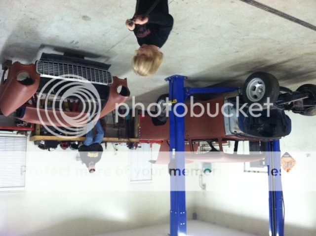

I got a few small things done to the new car in the past few months. First thing on the agenda was to get the brakes squared away. The car came to me with manual drum brakes all the way around, with a bad master cylinder that kept getting worse the more I drove the car. To remedy this, I ordered up a power brake conversion from Danchuk. I had scored a nearly brand new disc brake conversion/dropped spindle kit for my old project car a few years ago, so I figured that would be a nice addition as well. The install was pretty straight forward, and I got the new brakes setup over a weekends time.
The new stance in the front was just what I was after, and to compliment that I added a 1.5" block to the rear. (The block was a leftover from a 1/2 ton Chevy pickup a buddy of mine had put a lift kit on, so that was a freebie).
Here she is after the brake upgrade:
New booster/master cylinder:
With that work done, the car was much more fun to drive, and I got to enjoy cruising it for the rest of the warmer months. Closer to the end of the season, I noticed the car would start to get warm if I was sitting at at traffic light, or going slow. This problem got worse as time went on, so I decided to park the car for the year since the weather was getting worse right along with the overheating issue. As luck would have it, I came across a guy selling a 3 core radiator with electric fan setup on the local Craigslist.

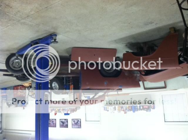

When the time came to install the new radiator/fan setup, I wandered out to the garage, popped the hood on the car, popped the top on a beer, and surveyed the situation. The first thing that always came to mind when looking under the hood was, "Damn, it sure is ugly under here", and this time was no different. So, in the same way I'm sure most of you justify the work you do to your car, I decided some changes were in order. A couple hours later, this is where I was:
The next weekend brought this:
The plan 1:
-strip and repaint under the hood, inner fender wells, splash pan, core support, and firewall body color
The reason/justification 1:
-all of these parts were rattle-canned black, and its starting to show its age, and was ugly. The previous owner included a left over pint of the original blue the car was painted. I have the paint code, so I think I'm going to have some new paint mixed up to paint the stuff under the hood, and keep the original pint for touch-ups.
The plan 2:
-get a gasket kit for the motor, a new water pump and thermostat, along with some nicer "dress up" parts like valve covers and air cleaner. Install the throttle body fuel injection kit I have on the workbench.
The reason/justification 2:
-the car was doing a pretty good job of marking its territory in the garage, and I want to completely re-do the cooling system for peace of mind anyway. I got the throttle body fuel injection from a buddy of mine for a song when he took it off of his rock crawler.
The plan 3:
-replace the TH350 with a fresh 700R4
The reason/justification 3:
-I really want an overdrive transmission, and it goes right along with number 4.
The plan 4:
-re-gear the rear axle to a 3:73 ratio and install a limited slip diff.
The reason/justification 4:
-1 wheel peels are not cool, and the new gear ration should compliment the new transmission nicely.
The plan 5:
-install the Painless Wiring harness I had bought for my other project car.
The reason/justification 5:
-the stock wiring for the car has been hacked on pretty good over the years. I have the wiring harness on the shelf, and I've got a mild case of OCD when it comes to wiring. It will also make life easier when I go to install the stereo system later down the road.
Well, thats where I'm at for now. Hopefully I'll start making some progress on this thing in the next couple of weeks and I'll have some more pics to share. Like the Wife told me when she saw the car in a million pieces on the garage floor:
