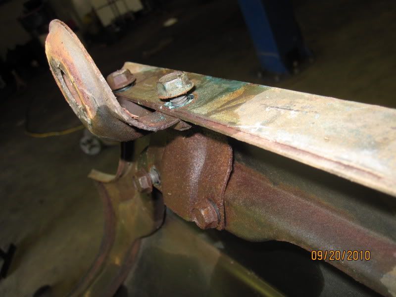

After the fender removal, I started taking off the trim, after I put on some penetrating oil on the back of the clips.....I used a 3/8 socket.
The brackets here, I used a 1/2 socket and more penetrating oil...

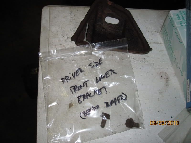

Now I don't know about yall, but this is how I keep up with my nuts/bolts during my assembly and disassembly...

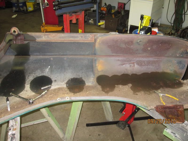

After getting the trim off, I had a couple of clips that would not come off the fender (nut on the back wouldn't come off, rusted on), I took my die grinder and cut off the round "head" in the middle of the clip. After you do this, the clip falls off...
Then, I go find some aircraft stripper paint remover, and put it on pretty thick with a paint brush.......DO NOT GET THIS STUFF ON YOU, IT BURNS!!!!!! And it is AGRESSIVE!!!
This is what it looks like right after it is applied, it does this as fast as I can apply it.
Then, I scrape it off with a cheap ol putty knife,
AND AGAIN, DO NOT LET THE BLISTERED UP PAINT GET ON YOUR SKIN, IT WILL STICK THERE, THEN START BURNING!!!! Of course it won't kill you, but you WILL be looking for the nearest water spicket, ask me how I know....
After 2 applications, this is what it looks like.
Then, it's onto the DA sander
Then flip it over and start on the other side....
I found a couple dents that need to be addressed while sanding, so I circled them using a permanent marker....

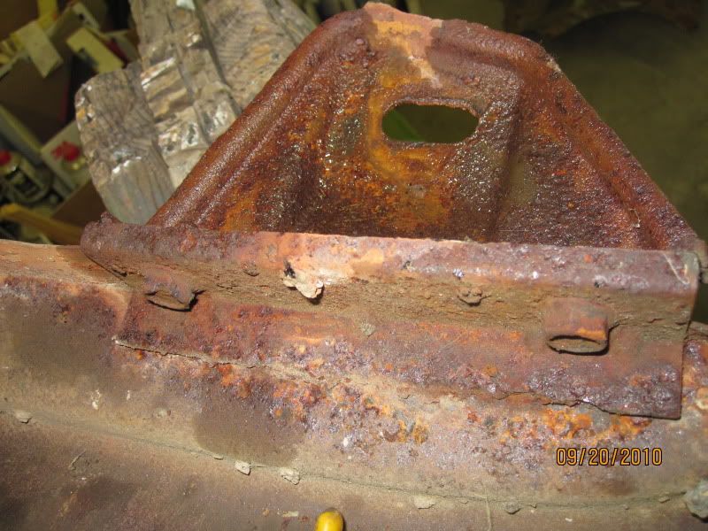

Here's the SAND and TRASH that came out from behind the fender inner structure and the fender skin while I was sanding it with the DA. So I'm gonna to all my body work to the fender BEFORE I take the bracing off and address it. It's got to come off, I know there is some damage behind there, and I'm not going to let it ride back there and come back to haunt me later.
Plans it to take the brace off, sand blast it, replace metal, POR 15 it, POR15 the back of the fender, then weld it back on.

Looks like you have a good bag-n-tag plan there. I did the same to most of mine. most being the screw-up option.:D The fender looks like most of them out there.

Nice work. Looking forward to more of your post! I used butter dishes to put my clips, nuts and bolts in and wrote on the lids what was inside. The bag idea is nice because you can see inside without opening it up, cool idea.
