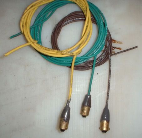

While installing a Dakota Digital dash in a vehicle that we didn't want to cut the original wiring harness I came up with this idea. It originally had idiot lights so I made pigtails from old light bulbs for the signal indicators, high beam, oil pressure, and temp...
Don't laugh, it worked...

Man and i replaced the whole wiring harness to make it work. Just kidding. I did replace the harness but not for that reason. Nothing like good ole ingenuity.
