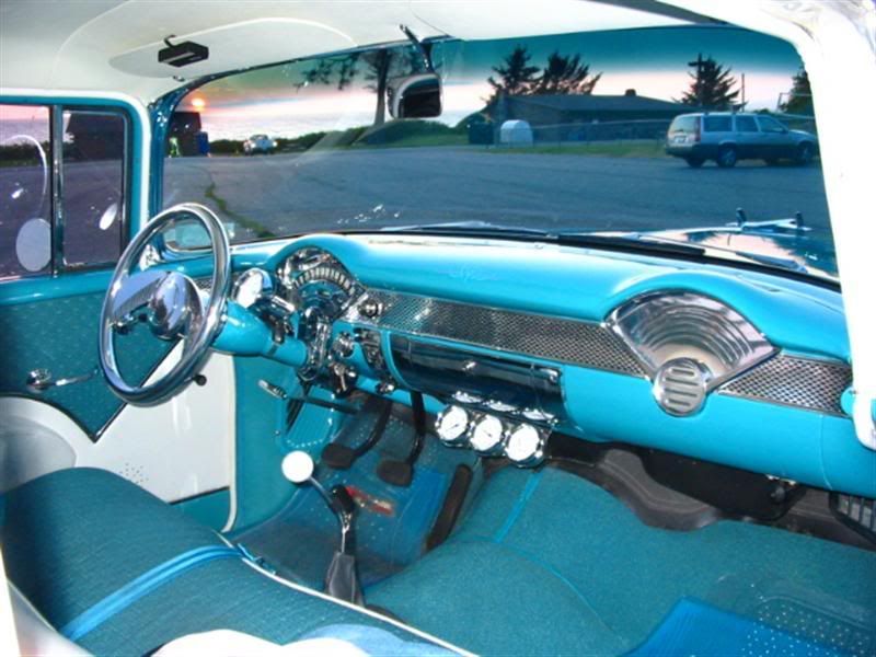

This is an older picture of my interior (I no longer have those gauges, that tach or steering wheel or aluminum in the speaker "V").. the Tremec shifter is in the rearward position. If you look closely I have a very slight curve on the front of the bench seat. I used a standard Hurst bar bolted to a Steeda "short throw" shifter that was MUCH better than the stock 3550 Tremec. I think the more modern TKO series has a better shifter. I put a very slight bend on the shifter bar putting the knob/ball towards the drivers side an inch or so just for comfort. I always keep the seat all the way back to accomodate my long legs. It shifts pretty good with this set up.
