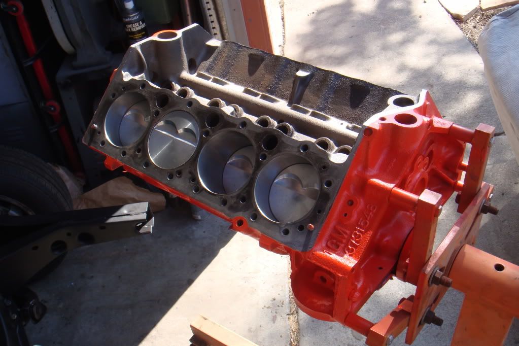

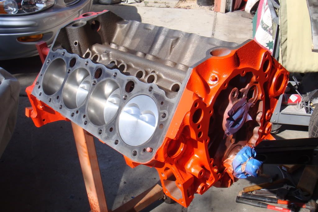

I just got my 283 short block back from the machine shop its .40 over with forged pistons. Talking to the machine shop guy, he tells me that i would get more power and spend just about the same $$ if i just got a set of aluminum heads rather than rebuilding the originals. I do want as much power as i can get from the 283 but on the other hand i wanted the stock look. I also went to the ends of the earth to find numbers matching heads, intake, and carb. I cant make up my mind. has anyone used aluminum heads and intake and carb while still maintaining the stock look?
