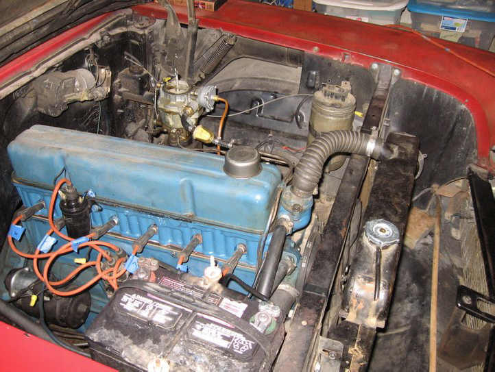

I hate to admit it, but after all these years of working on the car and getting it close to drivable again, I give up on the 235. I cracked the head last summer and got water in the oil.
So, I replace it, replace the bearings, did not turn the crank AGAIN even though I should have, and it runs, but not well. I had plans to beef up the motor and put in a new intake and exhaust with headers and an over drive tranny, but I can spend the same amount of money and have a different motor.

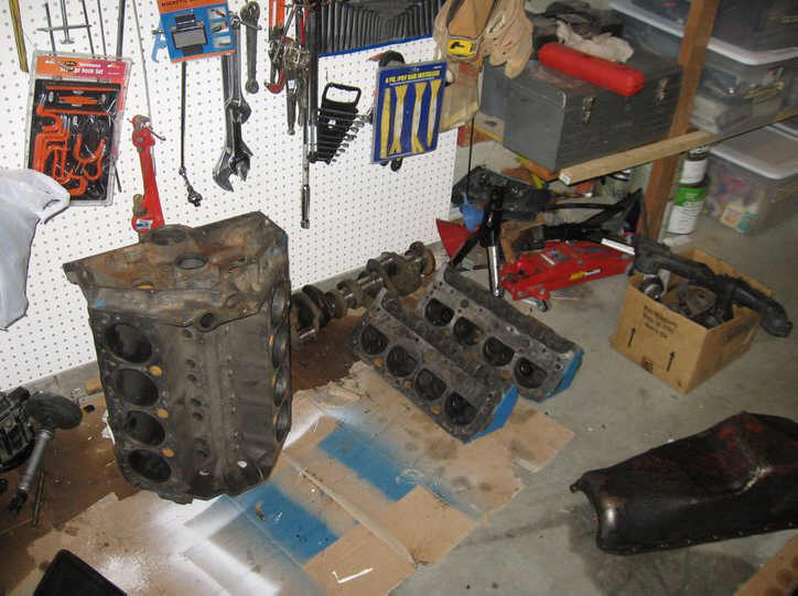

So I bought a 283 this week. It's from 4/16/67. Came with powerpack heads(same year as block) and ramhorn exhaust one is a 57 and the other is a little later. Crank is a 3849847 and has been turned and ready to go. Now I just need a cam and lifters, and a carb. Don't know what I want with those yet, but I want a daily driver so nothing too crazy.
So when it's done the motor will look like an original powerpack and I'll put in a new overdrive tranny.

If you mean the 235, I did replace the head. I had a spare parts car that I just got rid of. The motor runs, but needs the crank turned and valves set. I'm sure that's why there is a miss.
I could spend a few days and get it running fine, but I've never been happy with the stock configuration. Long term for me to put in a new tranny and make it a daily driver, I need to get an adapter plate (about $250), new intake for a four barrel carb (because the two barrel adapter wont fit under my hood like a 55 and 56),and fenton headers (because of the new intake). So after all that I might as well spend the same amount for a motor that will give me more HP and cost about the same in the long run.
This is a decision that took me almost a year to make and I'll miss the blue flame, but I want to drive the car and I'll be able to get a small block up and running faster and with more parts available when something breaks.

So 4" stroke journal is going to be turned down to fit in my small journal block. Block has been bored to 4" (it's not a 57 block so it's fine). The intake and 2.5" ramhorns have been ported to breath as good as possible. There is a roller cam kit going in. The cam will be a street cam that's not too crazy. The intake I'm going to powder coat Chevy orange and the heads have been modified to fit Tri-Five valve covers. I'm going to do as much as I can to make it look stock. I'm even going to shave off the side motor mounts. The radiator has stock tanks on it, but a newer core, and I have a 57 air cleaner to top it all off.
So when it's done it will look close to a 283 as I can, but have some decent upgrades.
