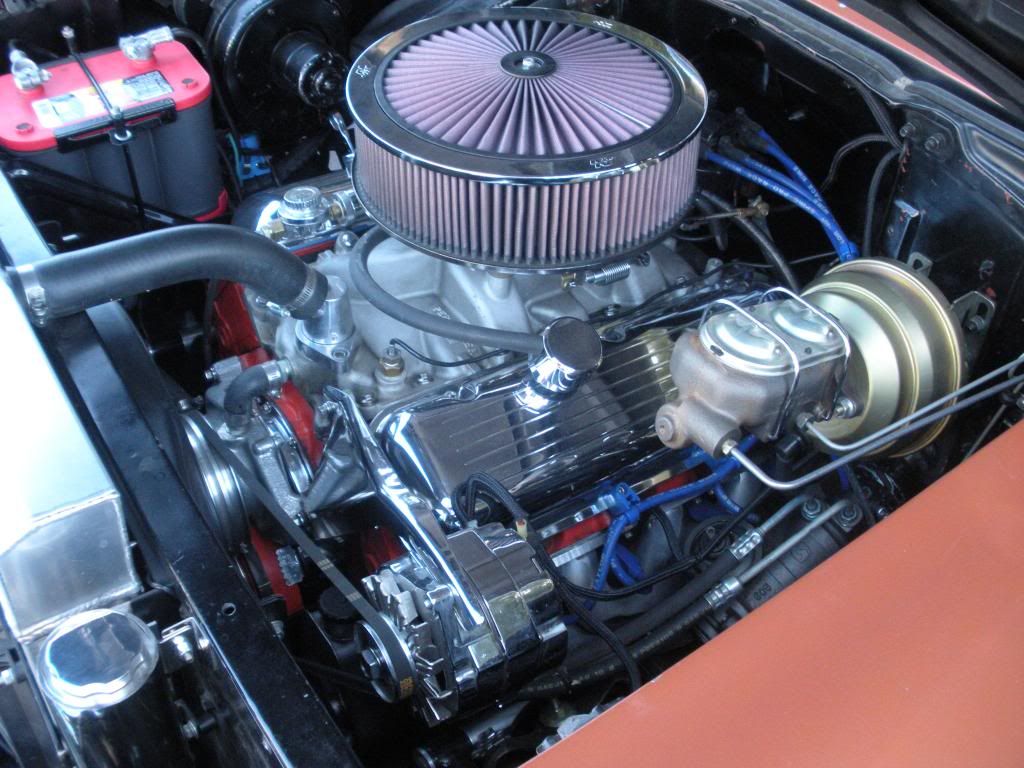

Looking for information on installing a 454 in my 57
#4 ·
Joninomader (and anyone else with a BB install),
Would you mind sharing details of your install? Specifically: steering arrangement, mounts, headers, fuel pump, starter and anything else you think may be helpful. I'm at the crossroads now where I'm ready to start ordering all these components.
My plan is to go with manual steering using the roller bearing pitman/idler arm upgrade, brake booster (disk brakes) and I'd like to leave the firewall alone, if possible.
Thanks!
#5 ·
More than one way to skin a cat.
There are at least a dozen options. Engine in stock location and hammer the firewall for clearance. engine set forward. . Front & side mount. Three point mount. modify oil pan . modify steering linkage. Hedders. Cast iron manifolds. It varies. I wanted to install a Pontiac 400 in a 56 chevy. The work involved was problematic. especially since the Pontiac starter is on the drivers side(interfered with the steering gear). So I frame clipped it with a camaro -firebird subframe. I got front disk brakes . forward mounted power steering and the engine bolted in. It would work equally as well for a Big Block Chevy. lots of info here.
