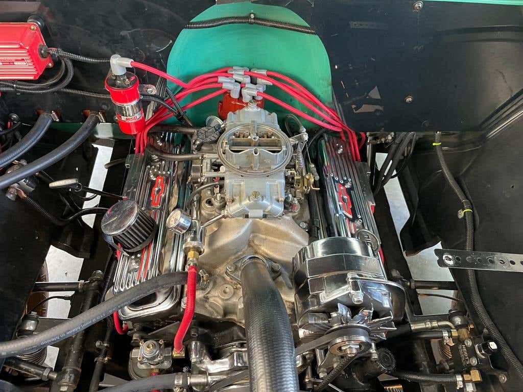

I just got done installing new 8.5 MSD plug wires with new plugs MSD cap and rotor in my 350 Chevy, a tame one. I had a previous post about some screws securing the rotor that had rusted. That all worked out ok and I am now back together and running. I have enough knowledge to be dangerous but now I’m not sure how to proceed. After having the MSD billet distributor out I wanted to be sure my timing was set correct, there are a lot of opinions about base timing and this is what I did. With vacuum blocked off I set timing to 4 degrees BTDC and it started and ran good. So I connected the vacuum then ran the rpm’s up to 3000 but my advance stopped around 18 or20. So then I tried another option set base idle to 10 degrees BTDC and it ran terrible. As I mentioned in the previous thread I was surprised how rusty everything inside the distributor was, I guess this is common with the HEI ignition (ionization?). As I said things were pretty rusty inside the distributor and I cleaned all the surface stuff I could get at. Springs on the top, one looked ok the other has some rust. The pickup was very rusty. Do you think this is where my advance problem stems from? In the written log the previous owner provided he did have the advance set for 32 degrees at 3000 rpm. I see that I can buy the internal parts and rebuild if you feel that is the answer? Suggestions and a current timing method are welcome. This is a daily driver do you see any issue with continuing to drive it? Thanks for any and all suggestions!

I see you are running an MSD ignition module in your photo. I am sure you know this, but if your ignition box is an MSD 6AL unit, the multiple sparks below 3000 rpm will require a special timing light. I bought this Perf Tool W80578 from Summit for $39. It is made by flaming river and runs off of 2 D cells. It is plenty bright inside my garage.
