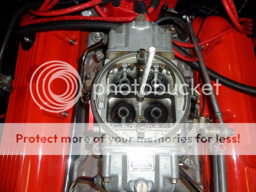

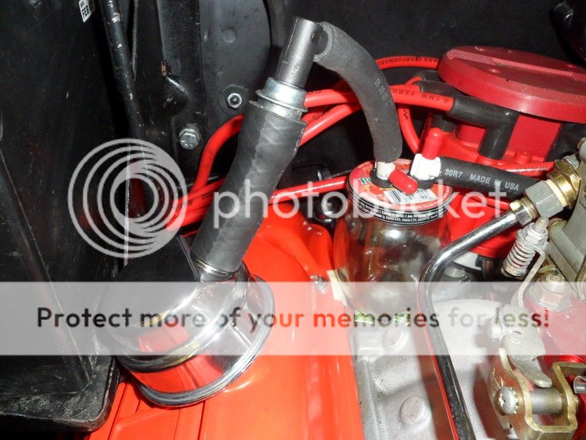

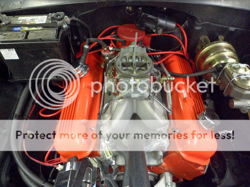

I had a major oil use problem with my 396 that I solved.
When I got the car, it was using about 1 qt. of oil in 100 miles and smoking like crazy. The PCV was configured like this in the standard location with no baffle.
I made up a quickie catch bottle to see if the PCV was the source of the oil loss. Well, it would fill up about 1/3 in five miles, so I figured that was it. I added a Mopar style breather/separator and relocated it to the top of the valve cover (drilled out the blank spot provided) to get it away from the oil splash in the valve cover.
I still get a small amount of oil in the jar, but nothing like it was and it uses almost no oil at all now and no longer smokes.
I plan on monitoring it for a while and eventually removing the jar and re-configuring the setup to look better.
If I don't run a PCV, it pukes oil out of the rear main. Normally I would say that the rings are bad and there is an abnormal amount of blowby. But this is a new build and the plugs look great. I had read that Chevy big blocks need a PCV or it will do that regardless. I'm not sure if it's true in every case, but it is in my case anyways...

fiftyfive210,
I could be wrong but in your first pic it looks like the placement of the PCV hole might be right over a rocker, at speed it would spit oil right up into the valve. In your 2nd and 3rd pic with your 'test' contraption it's obvious that you drilled out the blank cover hole and plugged the first one. That alone might have helped. There's also the possibility that your valve might have stuck open. I had that prob once myself. It took a while for me to find out that mine was only partially closing.
Also, on an unrelated subject (sorry), your intake looks like a Holley Strip Dominator. I really like them things, but I found through experimentation that my 396 ran FAR better on the street with a good dual plane, even an aluminum GM intake worked way better. I was bummed, but couldn't argue with success. I did find however that the Holley did work good on 468 plus motors. If you get bored sometime try a dual plane on your 396 just for kicks.
