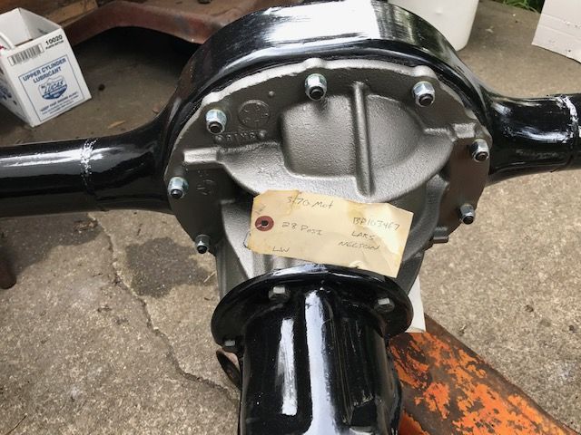

#10 ·
Yep..
Same issue here.Lots of trash.
First, a "GIVEN": Ford 9" rears leak!
There are some things to do, to combat the leaks.
1. Before installing the studs, I take a 3" cutoff wheel, on my die grinder, and knock the burrs off of the insides of the carrier bolt holes.
2. I chamfer the outer sides of the stud holes, in the hsg, & the gear side of the carrier, too.
3. The "folded" flange in the hsg, HAS to be cleaned out. You may/may not be able to run a wire thru it. I use air and brake clean.
I use only, the Permatex oil/lube resistant sealer. [In the black tube.]
No gasket, per Quick tech instructions.
The chamfers allow for the sealer, to form an "o'ring" around the studs.
Each of the studs gets a THIN wipe of sealer, just under the head, before I pull them in.
