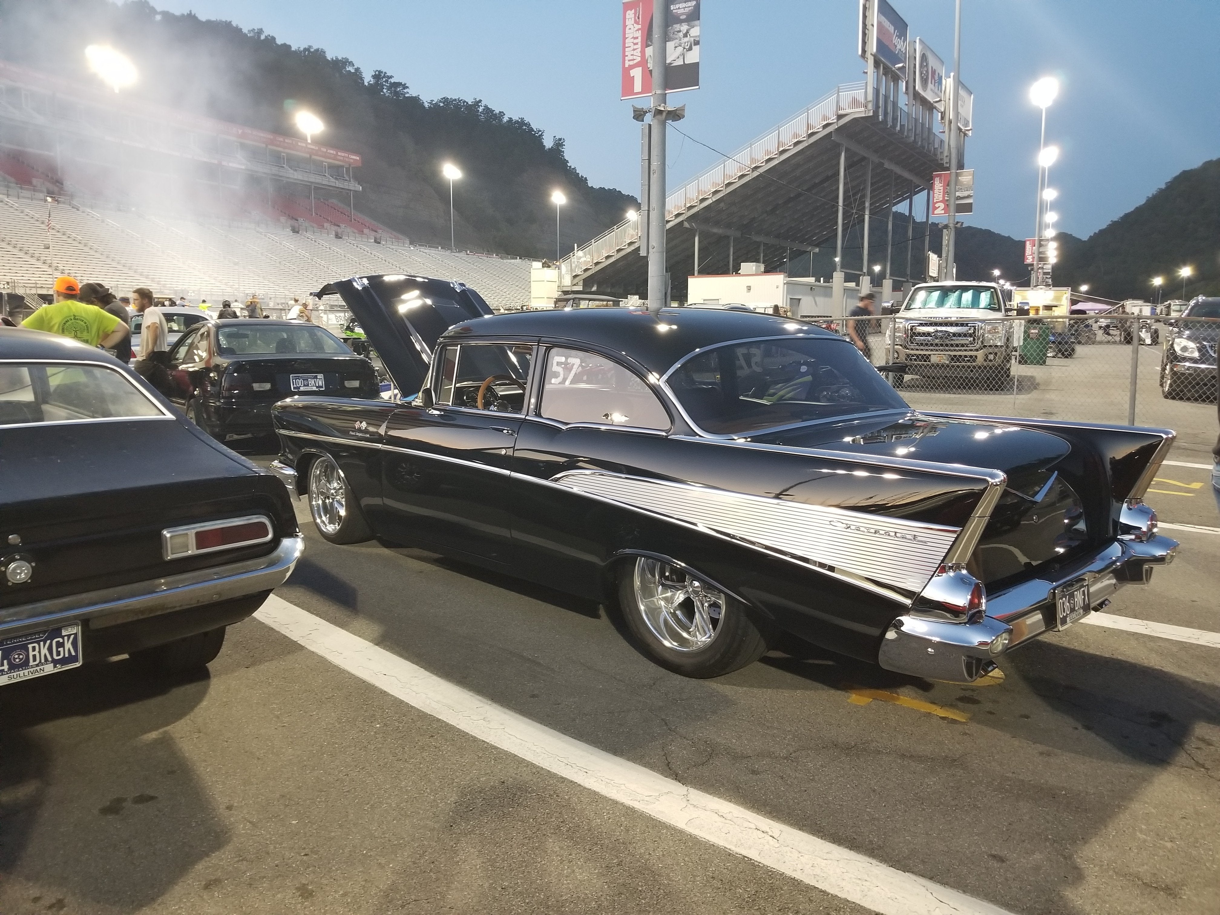

I have to say this about the tech inspection process. They were running a bracket race event this entire weekend, and Friday's test n tune that i went to was part of it. Tech inspection was a total joke. I mean, there was NO tech inspection whatsoever! The tech inspector guy sat inside a booth. I drove my car over to tech inspection, got out, walked over to him, and handed him a form that I had filled out. He asked me for my car number. I said I don't have one, its not a race car, its just a street car. He said, what number would you like? I said, I don't know, how about 57?
I signed another form, and I was done. He didn't check a damned thing on my car, or look at my helmet, or even ask me if I had a helmet. This isn't some backwoods hillbilly dragstrip out in the middle of nowhere. This is storied Thunder Valley! Even though this wasn't an NHRA sanctioned event, its still an NHRA track. I couldn't believe it.
I have to say, its convenient to live just 5 miles away from the dragstrip! If while I'm at the track, I ever forget something, a tool, a folding chair, whatever, it isn't a big deal to drive home and get it.
Nice looking facility, isn't it? Now you can see why they call it Thunder Valley, because in an actual valley! Notice how the shut down goes uphill.
