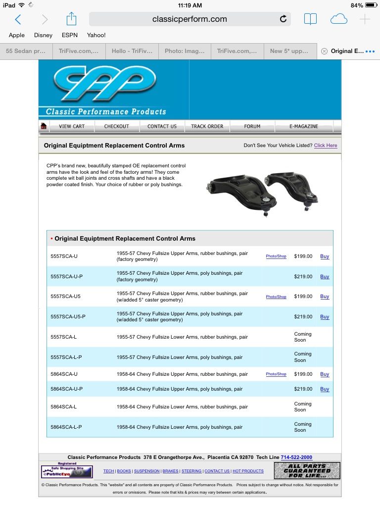

With tubular uppers and a 500 power steering box, how much caster is recommended? I think 6 degrees would be way too much, with wider than stock tires (225-55-16).
#3 ·
Don, most of the recommendations are for 3-5Âş of positive caster with power steering. I don't recall ever seeing aftermarket control arms with more than 5Âş extra, though I'm sure it's possible they are out there. So you'd have to go to some extra trouble to get more than 5Âş with a modified stock front end.

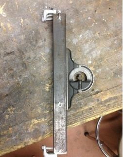

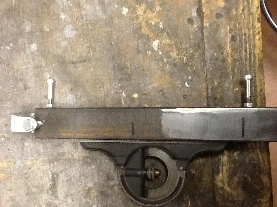

I'm still fine tuning the front end of my 55. Stock A-arms and spindles bias tires.
The stock spindles have four flat spots near the ball joint mounts two on the front top and bottom and two on the rear top and bottom. I've done some measurement and the flats seem to be the same distance from the center of the BJ to the flat spot top and bottom.
My question is with a special jig to set on the flat spots top and bottom of the spindle tires in the straight forward position. Can you measure caster with degreed angle gage.
Just trying to eliminate turning wheels 20 degrees in each direction an multiply by 1.5
So if I measure off the spindle and get 4 degree positive is that 4 degree positive caster. Thanks for the help. Ron

Thanks Rick that's what I was thinking but wasn't sure.
Yes I'm making all measurement on level floor with car sitting on the tires.
My jig is rather crude but it stays true. The Allen bolts I use on spindles, caster and the beem clamps I use on the outer wheel lip, camber.
It's not to bad to get to the front of the spindles while laying on the floor in front of the car. Ive double checked my reading after several short test drives and keep getting the same numbers. 5 degrees positive caster L R 1/2 positive camber LR 3/8 toe. Ron
