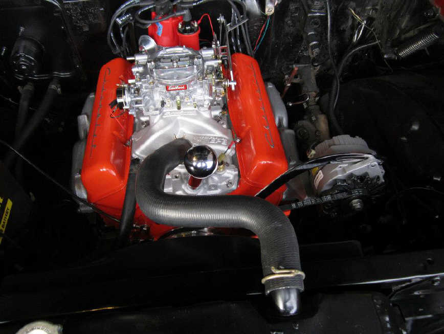

i never did find this info, so I'll post it in case someone else needs it.
This is for a six cylinder radiator in the six cylinder position and a 283 V8 with original oil filler. A normal V8 could just use this
Here are the numbers for the hoses:

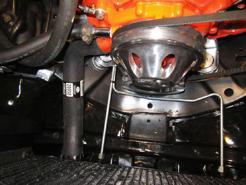

Lower- got from Danchuk, but you can get at any auto parts store
Gates 20958
Upper- This one was not listed with any supplier I could find. I had to dig through the hoses at a auto parts store. This one seemed to work well, but I had to cut five inches off the the end.
Gates 20827

Assume you meant 20958 on the first one. The picture differs from your text.
fixed
